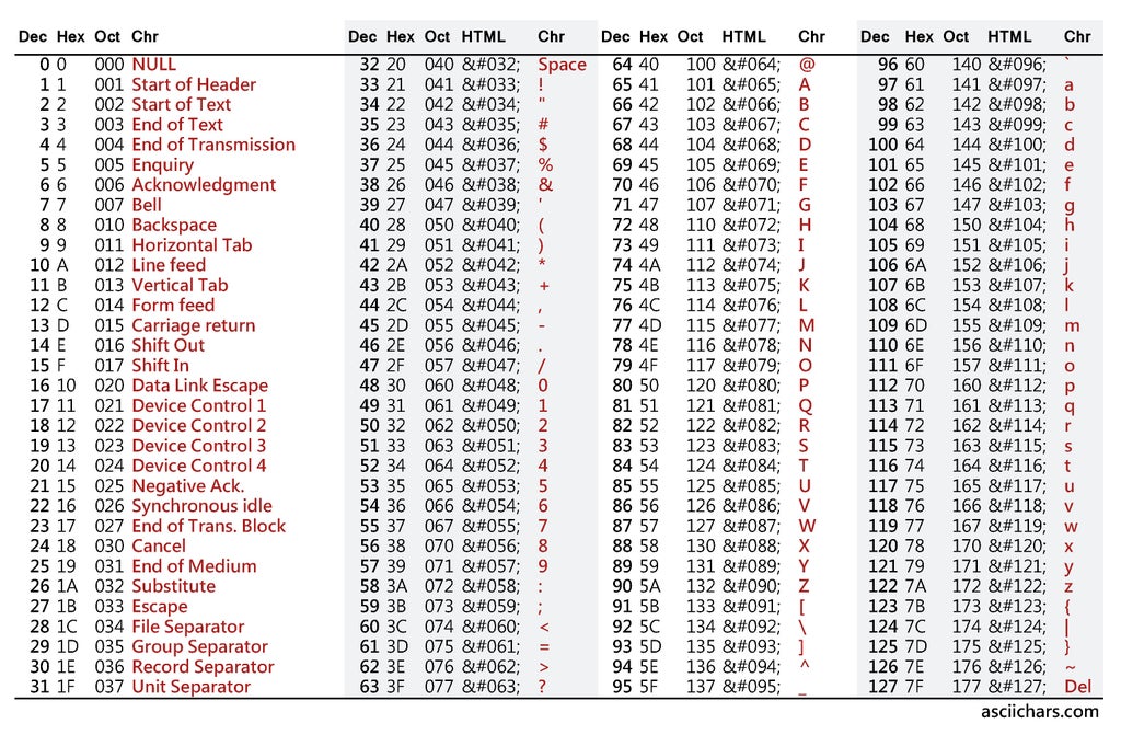

On an Arduino we can transmit up to 32 ASCII characters, or bytes, at a time using I2C, which is much more useful, and the character set includes numbers, letters and control characters in 7 bit format as below:
Fortunately, the Arduino compiler does all the work of conversion from character to binary in the background, but it still expects the correct type of character for data transmission and it won't accept 'Strings'.
Now is when things can get confusing. Characters can be expressed as single characters using the char definition or as a one dimensional array of 20 characters using char[20]. An Arduino String is very similar to a character array and is literally a string of characters often interpreted by the human brain as 'words'.
